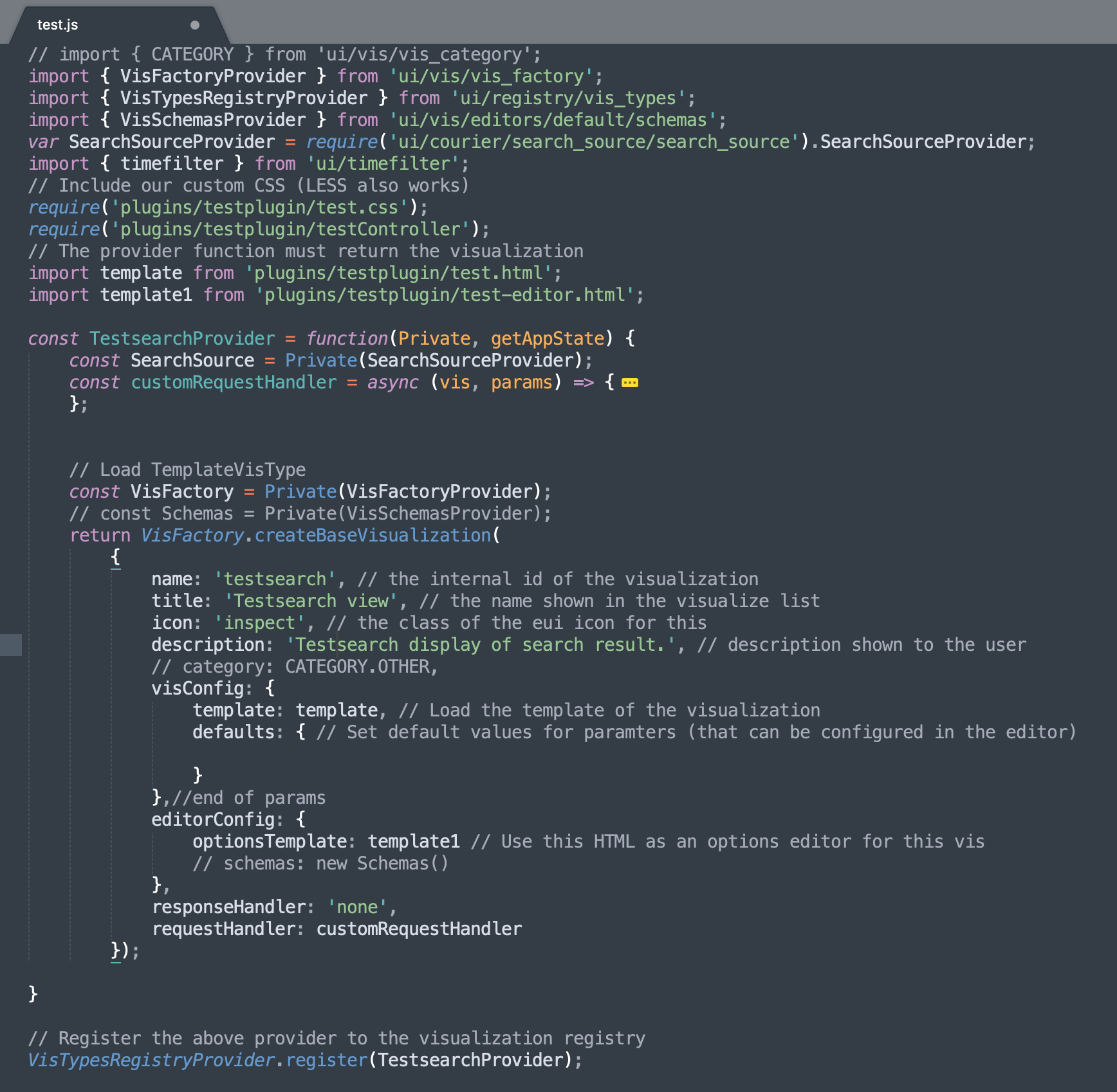

We are still using the old legacy architecture and we can not register the visualiations. We have different kind of custom plugins (visualizations, navbar extensions and applications). With Applications - all good but with navbar extensions and visualization - no luck.

Debugging missing plugins after updating from 7.6.2 to 7.9.2 . I know that we should use the new platform way of developing but we have many plugins and we dont have that many resources to do the migration immediately. Any hints on registering visType visualization with legacy architecture on kibana 7.9.3 will be much appreciated
Yea, after giving it a quick look, I can confirm, unfortunately. Vizualisation migrated during 7.9, so it is no longer possible to register vis using the legacy API in 7.9.
The hack Mikhail suggested seems like the only option. The ui/new_platform module (src/legacy/ui/public/new_platform for the full path) is the bridge we have been using to access KP apis from legacy plugins during the migration period. You should be able to use it to use the KP vizualisation plugin from your legacy plugin and registering the vis using it.

@Pierre_Gayvallet apologies for disturbing you that much but if I wanna use this hack with ui/new_platform module .. Is there a requirement that my plugin should be written in typescript ?
I am getting this error after trying to register the plugin by using
import { npSetup } from '../../src/legacy/ui/public/new_platform';
npSetup.plugins.visualizations.createBaseVisualization({
title: '..',
it is an angular plugin. thanks a lot

Hi @Pierre_Gayvallet still no luck.
This is an old plugin. Angular based. It was fine up to 7.3.2.
This is our structure.
Not sure how to apply the legacy hack:
most probably I should surrender and accept the we need to refactor old architecture to new platform :laughing:
That would probably be the best solution for mid/long term to be honest, as you will have to do it at some point if you want to follow Kibana releases anyway.
