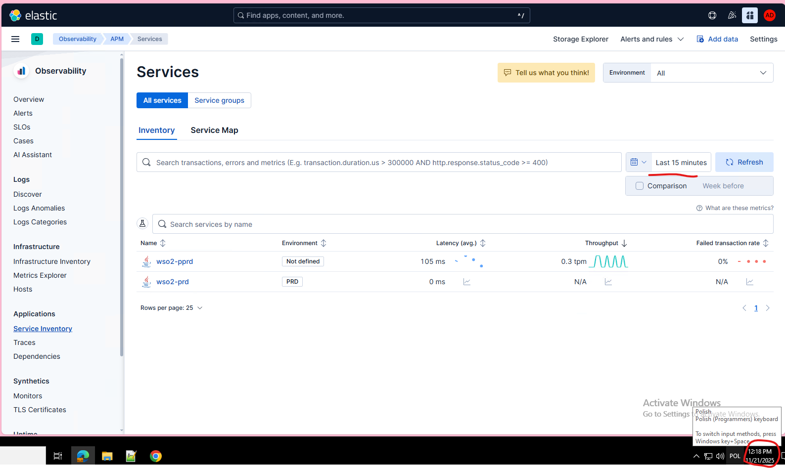

I am facing problem with disappeared services in Observability -> services
problem occurs when time range extend,
after changing to last 15 min
it also happens when extend to more time than 1-5 min
I observed that during changing services are visible for a microseconds and dissapeard

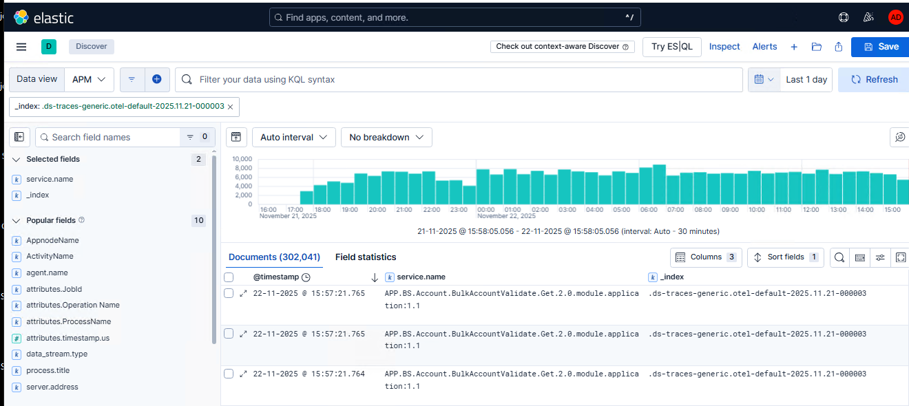

Also if you could check the index related to this APM service & see the data available in that index ? do we have the data say for last 15 minutes?

So when we keep the time range as 1 minutes & the OTEL service is visible.
Yes
What if we click on the service & than change the time range?
Services disappeared
From the source where the APM is captured on that host for this particular service do you see any issues or it is running without issues?
No all data are pushed to the.ds-traces-generic.otel-default-2025.11.21-000003 index
it is OK in .ds-traces-generic.otel-default-2025.11.21-000003 index
for 4 min
for 15 min
for 1 day
added some information in screens
