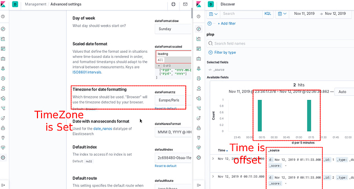

Hello, I am wondering how Kibana is handling timestamps' timezones when presenting documents in the discover section.
I was under the impression that Kibana would use the browser timezone if none was specified in the field but here is an example of a 1h offset when the timezone is not specified in the timestamp :
Here is how the fields were created for this test :

Here is what is presented in Kibana (with the javascript showing the browser's timezone)

Hello and thanks for taking the time to reply.
Sorry that I did not mention that I am aware of this setting that I had tried to modify without luck :
In this instance, what I don't understand is why is Kibana trying to "re-adjust" the time when all the components share the same TimeZone (ElasticSearch, LogStash and Kibana)
What mechanism is trying to adjust the time ?
Is it considering that the field without a timezone is a UTC time ?
Thanks
