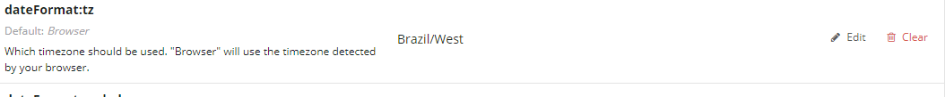

I´ve already tried changing my timezone, but I didn't succeed.
I changed the timezone on "Advanced Settings", "dateFormat:tz" like you can see below.
This is my computer local date, right now
But in Kibana when I insert the date "22/08/2017 09:00:00", it´s showing me
What am I forgetting?

Hello Mikhael,
I think it's specific of your date field in your document. Can you paste the JSON view of this doc ?
But to be sure : when you "insert the date", you mean that you choose a time range with the Time-picker (image) ?
Except error, Elasticsearch works only with UTC time and Kibana manage itself the documents date you watch to adapt with your timezone.

With the fact that elasticsearch works and index doc with UTC timezone, you have to specify in your logstash pipeline, in date plugin, the timezone of your "date" field ; here seem Brazil BRT (UTC +3, no DST).
Try to specify the timezone option.

Hi everybody,
I found a solution. But , I'm not sure If it's the best alternative to me.
What did I do?
I changed the dateFormat:tz in the Kibana to UTC. After did it, my Kibana has worked well.
Thanks for all attention
