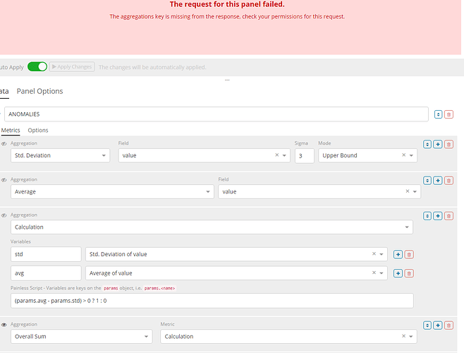

i am trying to use calculation aggregation in TSVB as below:
but is there way where i can find the number of events matching the criteria in the given timeframe using the painless script??? what other functions i can use in calculation agg.???
Please help....
i want to count the events matching (params.avg - params.std)> 0) condition??

here i am comparing the data for anomalies and if the current average value passes the standard deviation value, there i want to use metric tab in TSVB for displaying status based on the passed value (1 or 0). I want to know if it's possible to calculate the no. of instances for which the anomalies occurred, basically how many times does the average value passed the std deviation value...??
Is it possible in Painless script to get the count of anomalies occurred??

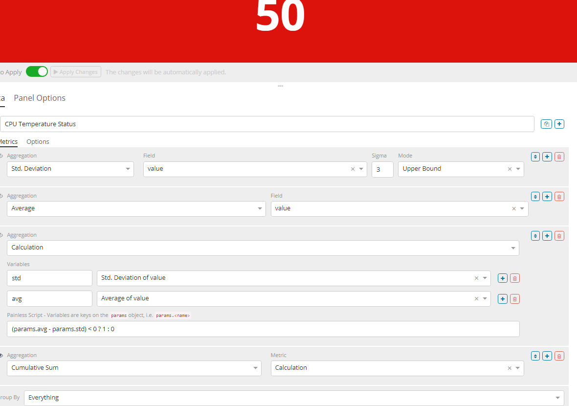

Thanks for the reply @ppisljar. And i tried the cumSum of calculation aggs and it gave an error.
You will want to use "Overall Sum" and then choose the calculation as the metric. That will sum up all the 1's and give you the total number of times it crossed the threshold.
@simianhacker Hi Chris, I tried your solution but it seems to give an error as well.
@simianhacker Hey Chris, can you please suggest what to do for this error in TSVB??
Which version of Kibana are you using? Does that error occur without the "Overall Sum"?
Usually that error indicates a permissions problem with the index pattern you're using.
hey @simianhacker, I am using 6.0.1 version. No, the error does not appear without "Overall Sum" aggs.

And also I tried with cumulative sum aggs
There is a bug with overall sum in 6.0.1 where it throws an error because the format of the buckets path for sibling aggs changed. It has been fixed in 6.1.1

Overall Sum is technically correct but cumulative sum should work, except there is a bug with cumulative sum in Elasticsearch: https://github.com/elastic/elasticsearch/issues/27544
@simianhacker Yeah I tried with cumsum few hours back it was working fine but after some time it keeps giving the error "The request has failed for this panel .
Also sometimes while grouping this agg on terms it gives that panel error.
Yeah.... cumulative sum is hit or miss because of that bug. 6.1.1 is pretty solid
