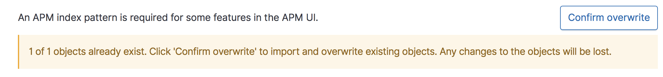

No I don't log out. I went to the page as shown in picture below and clicked on Load Kibana objects. I am in the middle of development . I am trying to add new tags to my spans. So I reload everytime i do a code change. Stactic look ups does not reappear at all once you do Load Kibana Objects and click on Launch APM button. You end up recreating static look up them again.

I reproduced it, I think, you have a static lookup on the apm index? If so, then clicking Load Kibana objects will clear static lookups.
I see this message:
Is this what you are seeing?
Thanks,
Liza
yes that's correct.
Thanks @anjana1I believe this is expected behavior.
