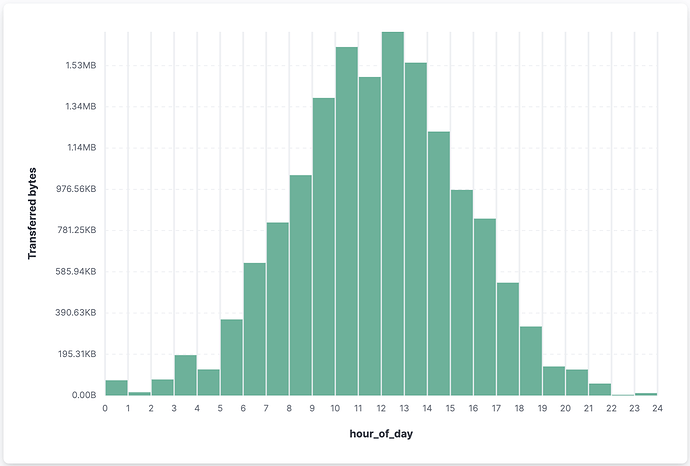

Transferred bytes Y-axis labels need to be more rounded up
Here is a picture from Create your first dashboard | Kibana Guide [8.2] | Elastic
The transferred bytes labels are 1.53MB, 1.34MB, 1.14MB, etc.
The ask is to make them into more rounded numbers.
Like, 100, 200, 300, 400 etc.
Given the time filter at the top can switch to a different time window, and the chart will assume a different shape then, how can the visualization get smoother labels.
Any suggestions would help.
It's possible we've fixed this as I'm having a hard time reproducing on the unreleased 8.3 version (which hopefully means it's going to be fixed soon!)
Will check with the team but this PR looks like it might've addressed the issue [Lens] Use elastic-charts axis calculation by flash1293 · Pull Request #130429 · elastic/kibana · GitHub
