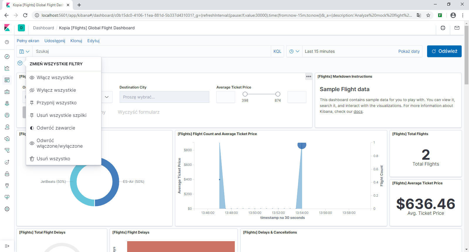

Of course
when file named "fr.json"
when file named "pl-PL.json"
As you can see there are some default strings (in red boxes) and some translated into polish.
I don't know what are you getting at with this, but i've got as many zh-CN.json files as pl-PL.json files.
Thank you
It's possible that you might have hit the issue described here: https://github.com/elastic/kibana/issues/55759
Can you try again with Kibana 7.6+ and see if you have the same problem?
