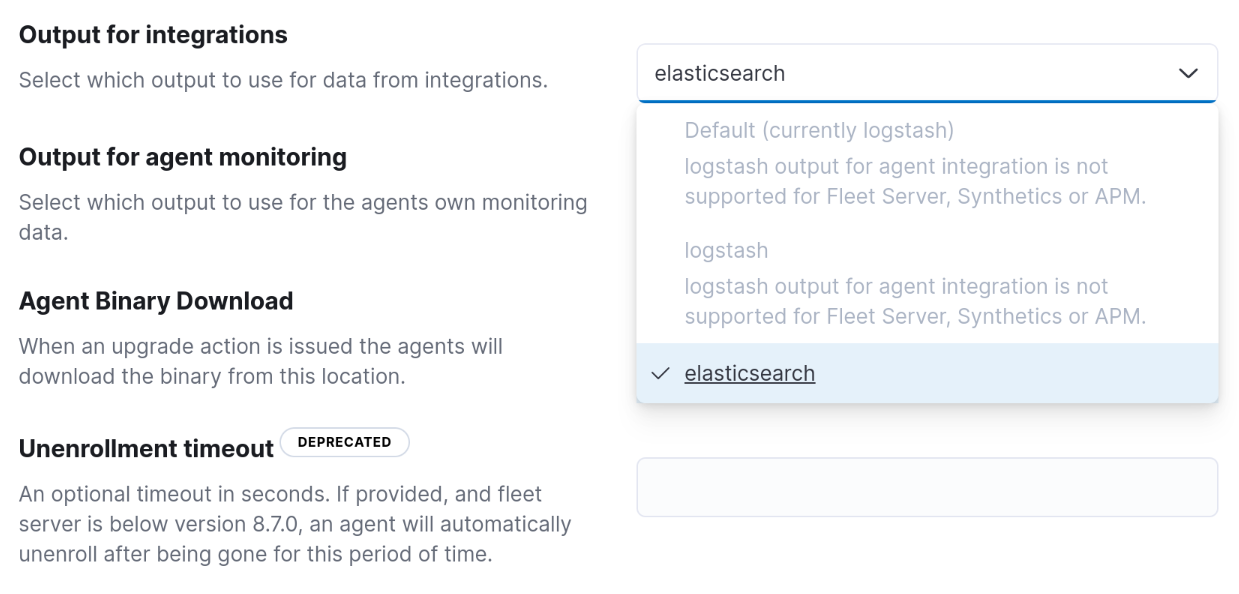

The basic license has a limitation that does not allow you to have a different output per policy, but you can use the logstash or kafka output if you want.
To do that you need to add an logstash output and set it as the default output for Logs and Monitoring, you need to have an elasticsearch output as well because the Fleet Server can only output to Elasticsearch, never to Logstash or Kafka.
After that you will see that your fleet policy will still be configured to send logs to Elasticsearch, but your other policies will only use the default output, which will be logstash now.
You need to have something like this in your Fleet output settings.
Then, your fleet server policy will have a configuration like this:
And any other policy will have an output like this:
