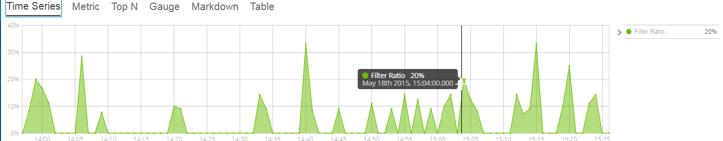

I'm trying to use Visual Builder to compute a ratio, on a given time period.
I use the log sample data (https://download.elastic.co/demos/kibana/gettingstarted/logs.jsonl.gz).
I want to display the ratio of 404 error code among all request, in the selected period.
Here's what I do:
On period: image
And I get the following graphic:
but when looking the metric tab:
What's wrong in what I did?

Metric, Top N, Guage, and Markdown only show values for the last bucket in the date histogram. In your example, the last bucket has a value of zero. There is a lot of user confusion about where the values for Metric are getting pulled from. There is an open Pull Request that adds a new setting that controls the time range used for matching documents.
If you want to display the average filter ratio for the entire timerange, you will have to use a parent aggregation to keep a moving average. Then the last bucket will contain the metric that you are expecting.
