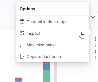

I noticed that I can change the offset by visualization via customize time range when viewing a dashboard:
But is there a way to change the time offset for all lens visualizations shown on the dashboard at once?
Thanks a lot
The time shift/offset declared in Lens is relative, so changing the time range in your dashboard will move also the shifts in each panel.
