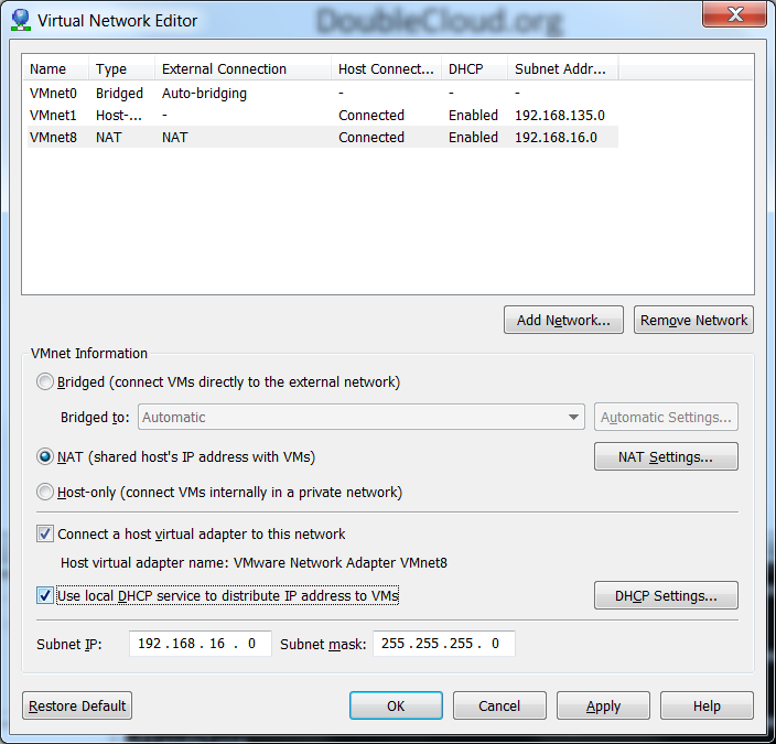

What program are you using for virtualization? Vmware workstation, virtualbox, fusion etc?
In workstation it looks like this:
