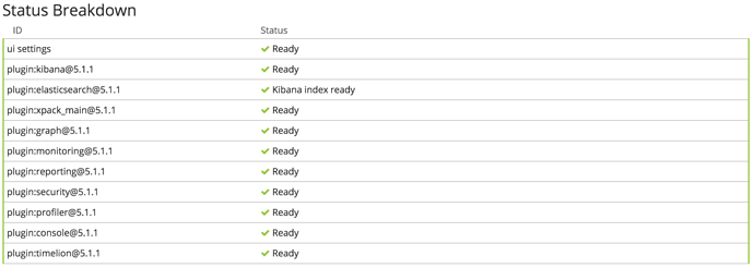

Can you screenshot your kibana /status page, per chance?
i hope this what you meant.
@Court thanks for any inputs
That's not quite what I needed, but from that screenshot I can create the proper link: Can you navigate to http://10.0.72.200:5601/status and screenshot that?
@Court sorry was prefixing app.
That's perfect, thanks!
Based on that screenshot, X-Pack is not installed on Kibana. Is it possible you accidentally overlooked an error message when you first installed it or something? To install it on Kibana, shut down Kibana, and then run the following command:
bin/kibana-plugin install x-pack
This will take a few minutes to download X-Pack and then to run the optimization process. When it finishes successfully, it will log Plugin installation complete. Start Kibana again.
At that point, if you navigate back to that status page from before, the Status Breakdown should include the additional plugins from X-Pack:
@Court I did install the same way i will try to uninstall and do it again and show you the logs
