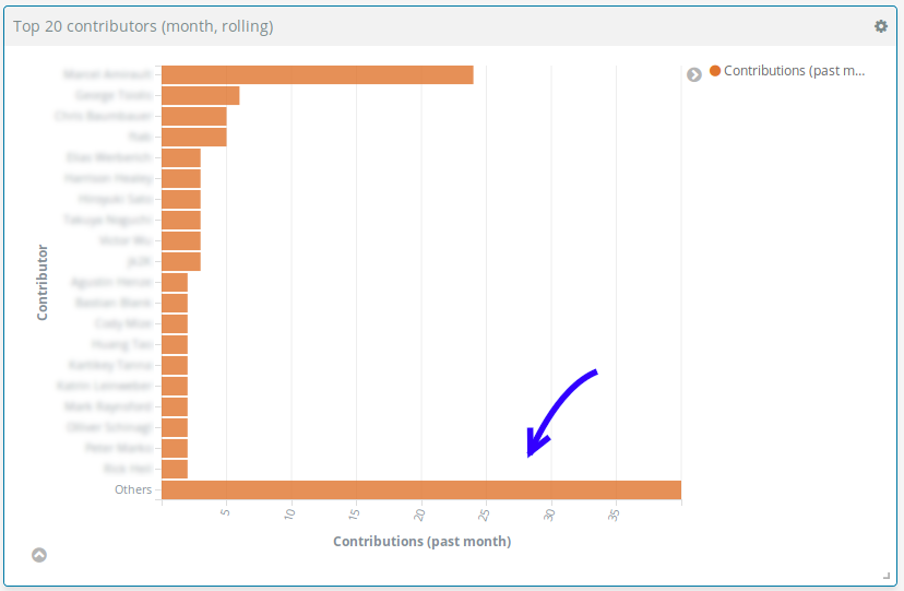

We're using Kibana 6.1.4 (via bitergia.io) to visualize community contribution data to a project.
One of the visualizations we're trying to set up is a bar chart of the top 20 contributor names ordered by their number of contributions.
We've set up a Horizontal Bar visualization that does just that:
Bar-chart-data
The "Others" bucket is added automatically in the visualization and we have no control over it. The only workaround we've found to diminish the impact it has on the scale of the Y axis is to check "Set Axis Extents" in "Metrics & Axes" to manually set the "Max" value of the Y axis to be near the maximum value of the contribution count of the top contributor, thus truncating the "Others" bar. Using the "Exclude" field under "Buckets" to exclude Others did not work.
In summary, we'd like to remove the "Others" bucket from the chart and display only the 20 buckets with the user names. Is this possible?

The others bucket is being hard-coded by the fork here: https://github.com/chaoss/grimoirelab-kibiter/pull/51/files
Argh, then I guess there is no way to discard or hide the "Others" bucket in this case.

I've ended up finding a workaround:
Add a Split Series sub-bucket, with a Filters aggregation. Then set the filter to * . This effectively shows all results and bypasses Others . See it here in action.
The only downside is that the legend's label shows "*" (adding a label to the filter ends up adding two legends, one for each bucket, which is confusing). I wonder if there a way to remove legends alltogether?
