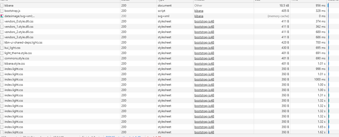

I could observe that kibana navigation between different pages is very slow.
The search looks fine. But if I go to discover and then to dashboards etc...that navigation is taking a lot of time.
Please note, that we have installed ELK stack but not performed any tuning.
Could you please let me know what information do you need to check what is causing this issue ??

Below are the screenshots from the network dev tools

When you say slow, how long does the navigation roughly take? If you look at the network tab in the browser, is it downloading all js files completely from scratch or is it using the browser cache?
Hello Joe,
Some times, each tab takes 1 or more than 1 minute.
From my observation, I think it is downloading all the js files from scratch.
A minute is definitely longer than usual.
Could you copy / paste all request header and response headers of let's say the vendors_0.bundle.dll.jsfile? Also make sure you don't have caching disabled in your browser.
If you are pinging the host Kibana is running on from your local computer, how long does it take? If there is a high latency it could also cause patterns like this because Kibana consists out of a lot of files.
