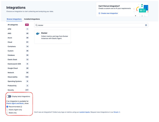

Hey there @pierro78 thanks for the question!
Please double check this setting on bottom left of the integrations UI in Kibana:
Selecting "beats only" will result in plain Beats tutorials being shown in the results as opposed to Elastic Agent integrations. There is a Beats tutorial for collecting Docker metrics via metricbeat that you're likely landing on.

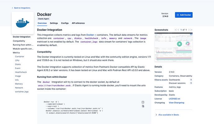

Enabling "recommended" or "Elastic Agent only" via this toggle and searching for Docker should bring you the Docker integration, which does not require manually configuring Beats:
Thanks a lot for answering but it unfortunately doesn't work ... I had the "Recommended" toggle activated ... tried with the "Elastic Agent Only" toggle but no docker integration in there apparently ... tried another integration in "Elastic Agent Only" but no "Add integration" in the integration page ...
